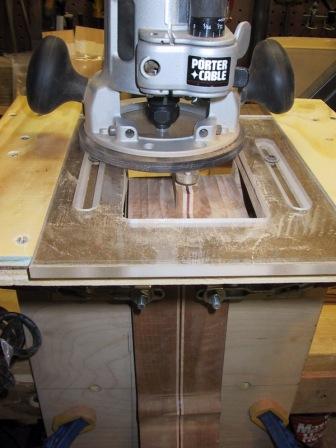

Here's a pic of what I use...it's a Stewmwc template on a jig that I made following their suggestions. I hold the neck blank in place with 2 Destaco clamps. Between the FB surface and the jig is a block positioned such that the angle is 1.5*.
It seems that all I'd have to do is alter the thickness and/or location of the shim on my jig (which you can't see on the pic) to correspond with the transferred body angle. An even better way might be to hinge the jig so that the planes would have an angular adjustment. Or am I missing something? This jig stuff is rarified atmosphere for me.
Any critique is appreciated.
